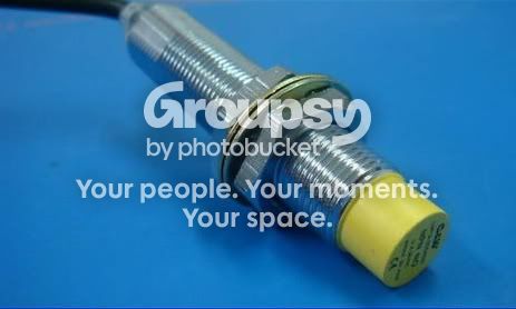

Proximity sensors setup
I'm finishing my wiring on my MM and i'm curently stuck
on the proximity sensors setup.
I have bought this prox sensors which are NPN, NO, 10-30VDC.
And these relays 12-24 VDC, NO / NC
I have wired them like this :
What i cant figure out is how do i set up them in mach3.
I tried some settings in PORTS & PINS ---> INPUT ---> X++, X--...etc but
no result.
The sensors are lit up (their led) when i start the MM and the led is off (just a small glow of the led) when they are over the hole.
However when the sensor is over the hole the BOB's led of Pin 11 where i have attached them doesn't light up.
And another thing is that my relays when they are energized are making
a very disturbing noise, like a small fan hitting the cover.
Is this normal ?
Thanks
