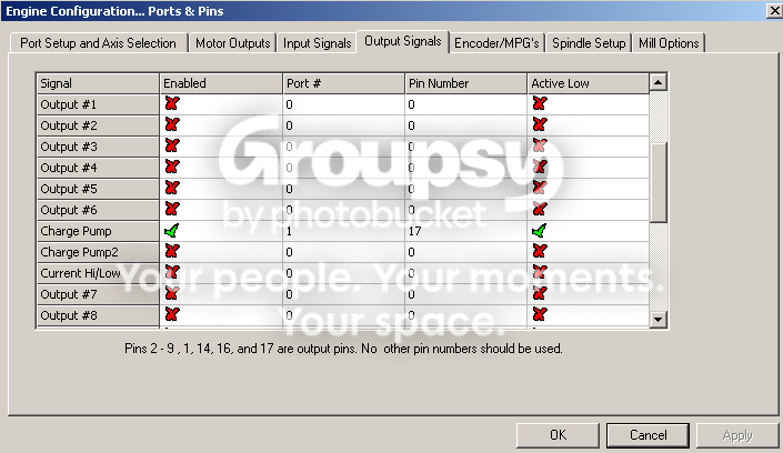

Motors won't turn
Hello again
Finished the rails (phew) and now i'm proceeding with the gantry.
Ordered my ground flat stock from David (cncbasher) thx Gerald !!! and....
...... received my motors from OM. (PK296AE-SG7.2)
But the good things ended when i tried to set up my kitchen table
I read the whole forum, contacted Steve from PMDX (waiting for his reply) and switched so many things without the motors to even blink.
I keep joging with the arrow keys on mach3 screen but no light on step & direction leds on my PMDX.
My BOB is the PMDX-125 (flame on).
Anyway,
I have attached some photo's from my mach3 setup and the wiring of my BOB-Geckos-Motors.
Any help welcomed
And here's also my .xml file from mach3.
Sergio.txt
Regards
Sergio

Sergio, it's a little tough to tell with the fuzzy picture, but it looks to me like J1 through J4 all have the "Common" from the G203V wired to "PC+5V". The G203V manual states that "Common" should wire to Ground, so "PCGND" would be correct.
This would make your control signals reverse voltage, and you'd get no motion. Doublecheck me before you make changes.

Hi Sergio, please also try change port n pins, Motor outputs to this. 9-8, 7-6, 5-4, 3-2.
As far as I remember it is not like stated in the manual. I will check when i get back to the mm and make a print. Have a nice weekend.

Brad you were right !
I did change the wiring from PC+5V to PCgnd and did achieve movement with
the boards TEST functions.
However when i tried to control it from mach3 i still couldn't move the motors an inch.
It's so confusing.
Claus
I did tried and altered the pin orientation like you said but still nothing.

Hi Sergio, maybe you could try different printrer port cable or check if all the pins have continuity with a meter.

I don't use mach3, but I note that on the screens above, you have the motors configured against port #0 ("step port" and "dir port" at the right side of the "ports and pins" screen, "motor outputs" tab. I would have expected it to be port #1, since that's the once you have enabled at 0x378.

Brad
Correct again THANKS
I feel so dumb
It was like i was sending signals to outerspace
We got movement !!!!!
