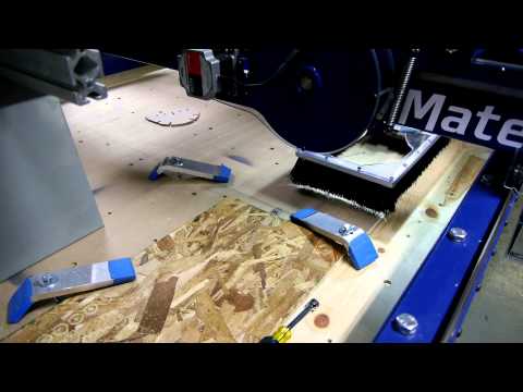

I should have posted this before but I lack the ability to always remember to take before and after pictures and videos. Here is a difference between the noise level of a 7518 router and a 2.2 kW wc spindle. Sorry no decibel meter.
Click the image or here
Reply With Quote
  #592
