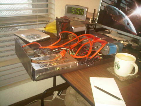

Got the controller, drivers and stand-in nema 23's, working. Took a drawing of the mm motor plate, cleaned it up, converted to DXF, loaded to CAM software, everything turned on, USB plugged in. The drawing came up in CAM window. Black cut lines, blue move lines. Clicked cycle button. The z motor made sounds, the drawing moved the tool location from home to the first cut line. The z motor sounded off again . The lines turned from black and blue to red as the CAM program was running. Looks like CorelDRAW is going to work for 2D and DXF files.

You can see I've dumped the 23's. Got 4 - 34's 400 in/oz steppers and a 8.3 amp 48v power. I found I've got to dump my control board. I called the developer and he basically said "Plasma!" Going with CandCNC control with THC, MACH3 , SheetCAM, CorelDraw, Hypertherm, keep my gecko's.
The BIG thing now! Move things around in shop, to make room for 4' x 4' plasma table location and build area.

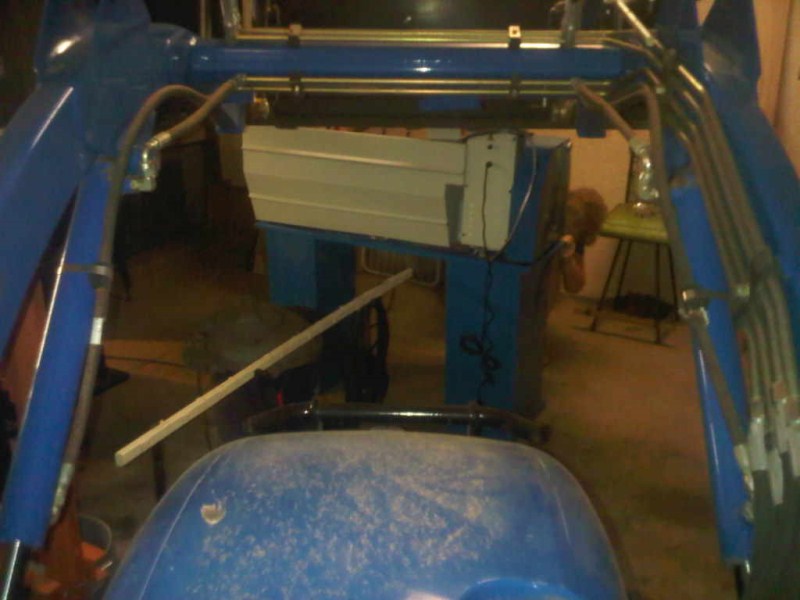

A slowdown coming up. I'm in a two car garage now, on the right, shared by my truck. I'm moving into the green outlined area. Single garage with 3 walls and a garage door. Really much more room because I can line equipment up on both sides of the new shop area.
This is actually a drawing of a central air, not install. You can see Their's a clean room next to the new area. 11' x 20' space for the plasma table and the moved equipment.
Vern
