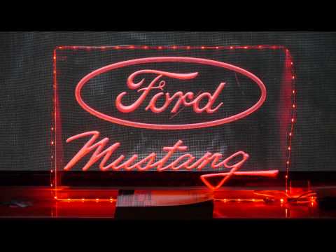

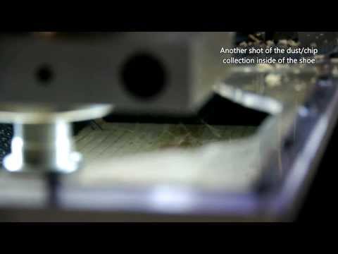

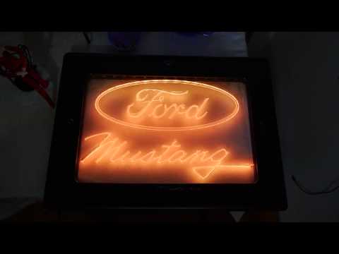

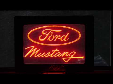

This wasn't without its form of frustration but it turned out nice in the end. Material is 0.500 Acrylic and 0.750" MDF. The LED's are remote controlled. I don't really like MDF for some things but it is nice for others. Everything has its place in life. I don't want this to turn into a debate on why MDF is bad or good ( have seen that on most every forum ). This is an indoor sign obviously. The color is a black metallic. The acrylic was supplied and not in the best of shape. I had a good deal of polishing to do on it. Many coats of paint and sanding on the frame with 320 and 600 grit paper to get the appearance I wanted. I used EZ-Lok knife thread insert nuts with brass screws to hold together.
Tom, I told you I had not forgotten and here they are......

And the videos
First cut and testing, on YouTube
Assembled, on YouTube
After Assembly and same position as first video listed above, on YouTube

Absolutely beautiful. Great job...
  #502
Old Tue 03 December 2013, 17:19
racedirector
Just call me: Bruce #122
New South Wales
Australia
Wow nice job!
  #503
Old Tue 03 December 2013, 20:03
pblackburn
Just call me: Pete #98
South-Central Pennsylvania
Thank you Gentlemen.
  #504
Old Tue 03 December 2013, 21:02
parrulho
Just call me: Paulo #108
willemstad
Netherlands Antilles
very professional look, very nice.
  #505
Old Tue 03 December 2013, 21:12
domino11
Just call me: Heath
Cornwall, Ontario
Very Nice!
  #506
Old Wed 04 December 2013, 00:30
Surfcnc
Just call me: Ross #74
Queensland
Australia
Attention to detail pays off, nice job.
Ross
  #507
Old Wed 04 December 2013, 03:42
Tom Ayres
Just call me: Tom #117
Bassett (VA)
Super Nice Pete, Inspiring!

The next adventure. I have a Jet 2HP Vortex dust collector. It works well, I am not complaining. Removes virtually all dust while I am cutting so I am happy with its performance. I have never seen anything but fine dust in the filter (but then again, neither do most that have one without the cone). The bag changing is not so bad but it definitely could be improved upon. A clear canister with a flexible connection hose with an air tight clamp would be ideal. The separation is not too bad but I would prefer to make a multi-part system. I usually transfer the dust to another bag for a friend who uses it. Clean the filter, cone, housing and contact area on the bag and reinstall. Since I use 55 gallon bags for the media that I give away, a small 30 to 55 gallon inline interceptor would be ideal. So I am making a Thien baffle directly before the collector. The only thing I did different from the original design was to make it flange mount. I made a flange to fit up around the lip of the container and sealed it to the container. I made two grooves and installed 0.139" o-rings. I have seen how important a sealed system is from working with vacuum at work. I know that any leak will affect performance. I expect to see a loss of suction because of this addition so I am trying to maintain a sealed system. If I can achieved an 85/15 ratio between the two systems as far as media collection is concerned. I will be pleased. I looked at the top hat design but went with this for the trial run. The top hat would require knife inserts as I do not want to break the surface into the chamber. If I go with a top hat, it will be flange mounted as well and i will be able to use the existing flange.
Parts are setting up with sealant now. I do not make near the dust as most of you here. As I said before, I do this for a hobby. I would like to change the top of the system from one filter to two using a Y connector to improve on the surface area for air to flow. Venting outside here requires a permit.

I'd love to see pics of your Thein baffled inline interceptor. Sounds intriguing.
Maybe what the Dr. ordered for my dust collection efforts.

First Test, pictures and video below
Orings on Flange and dust in container , on Flickr
Close up shot, on Flickr
Inside Assembly, on Flickr
Thien Before Jet DC Vortex , on YouTube
