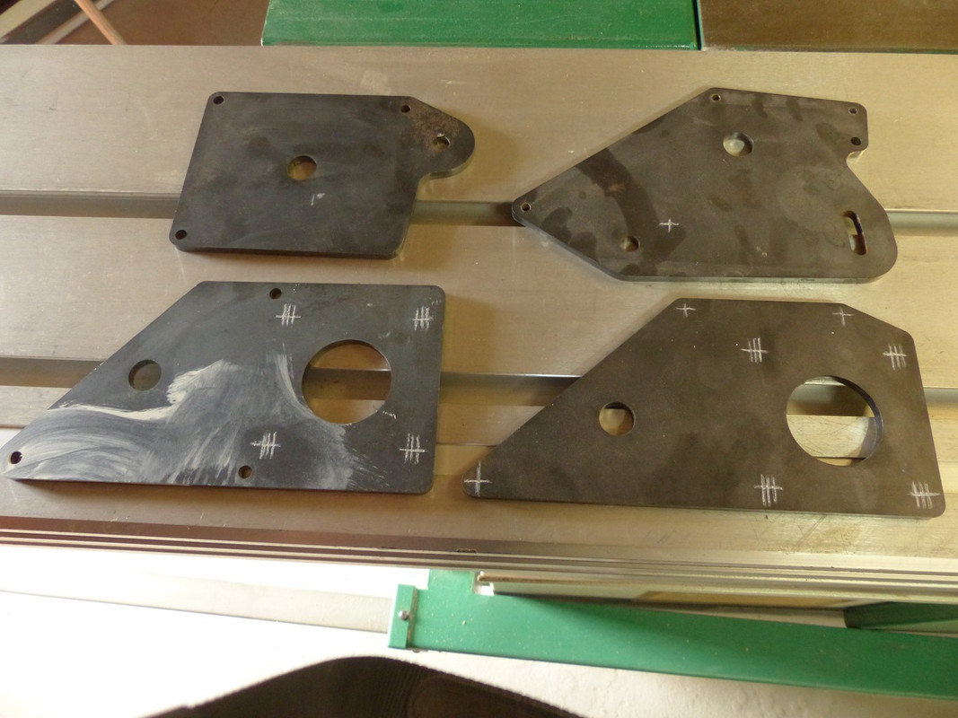

Lorsque j' ai commandé le kit, j' ai opté pour une démultiplication des moteurs.
Voici les platines ,a gauche celle du Z, a droite les autres(par3 donc).

n 2018, I made all the mechanical part of a mechmate.
You can find the whole history herefor the french forum whose name is usinage.com) http://www.mechmate.com/forums/showthread.php?t=5633
Unfortunately my business turned out to be black pudding and went without money for a few years.
As everything has an end, I find myself able to get back to investing in this machine.
In pure autodidact (I have just a bepc) and having worked in the restoration all my life, I compensate by a very great curiosity and an ability to read for hours.
I now have to tackle the electronic part and this is what seems to me the hardest at my level.
Fortunately I know there are great and generous people on the forums: smt023
When I ordered the kit, I got a gear ratio for the motors.
Here are the decks, on the left that of the Z, on the right the others (par3 therefore).(to see on french part of the post)
