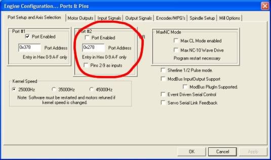

Curious thing though: we are running two BOBs with 8 geckos, and mach3 will not pick up the second BOB. If I enter the second BOB's address in mach's "port 1" slot, I can control it - but not in the other slot! I am still running the demo version of mach, maybe it's limited to one port? No one seems to know, will see soon when I upgrade the license.

I have a PCI card with two parallel ports, and have one parallel port on the motherboard. Each BOB is connected to a parallel port. I got the addresses for each port from device manager, and entered it in the ports and pins box.
Both work when I enter their addresses here:
Neither work when I enter their addresses here:
Obviously I use the correct addresses, have the "port enabled" check box ticked.
Therefore I think everything is fine and working, but that the issue lies with mach? Hopefully the "full" version won't have the issue? Or maybe I'm just missing something obvious....

page 61 Mach3 Manual

Yip, that's what I did, with above mentioned results.

Check the box to enable the port.

Mike he said it was checked.
I read one on the zone that even if the port was external pci card, one guy had to use the option in BIOS for LPT status ENABLE. Its worth to look if you have something like that in bios (advanced options or integrated peripherals).
But as they both work when used as port#1 it sure looks like something with mach. Try newest stable version from their site.

Both ports must be set as EPP (Enhanced Parallel Port) in the BIOS or window Control Panel. The device drivers will not read any port pins if the port is not set to bi-direction (EPP).
Secondly, the parallel port card must be EPP or better, but you have established that already as it works as port one.

Sorry, I just noticed this remark. Yes the unlicensed version does not enable the second port. You can set it up but it will not work. Once you install the licensed Mach, it will all come together.
